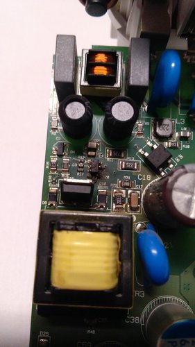

Hi guys,
I am new here and I don't speak Dutch, but I need your help on this Devolo model. Can you send me a photo of the area that has been burnt. I upload some photos to see
Thank you very much for the support.
All the info on the model I had and all the photos I uploaded can be seen while scrolling back / looking at the first page of this thread.

Max1966 thanks for your message, I have seen the photos but I don't know what kind of resistance and the ic are. If you still have this model and can send a clear photo, I would appreciate it a lot.

I left the damaged adapter at the store when I returned it and never got it back. And that made sense.
All the photos I made and had of the adapter I put in this post.
As far as specific parts go I can't provide you with further details.

Misschien kan iemand hier nog wat meer details vermelden over welke onderdelen waarschijnlijk doorgebrand zijn bij mijn of zijn adapter om Mecatron te helpen?
Mijn kennis schiet hier nogal (erg) tekort. ;)
Max thanks for your messages, this is not mine, it belongs to a friend and I thought it could be fixed.
Thank you again for the effort, unfortunately I can't find a service manual on the internet.
I believe yours blew up from a sudden high voltage in the electricity company.
